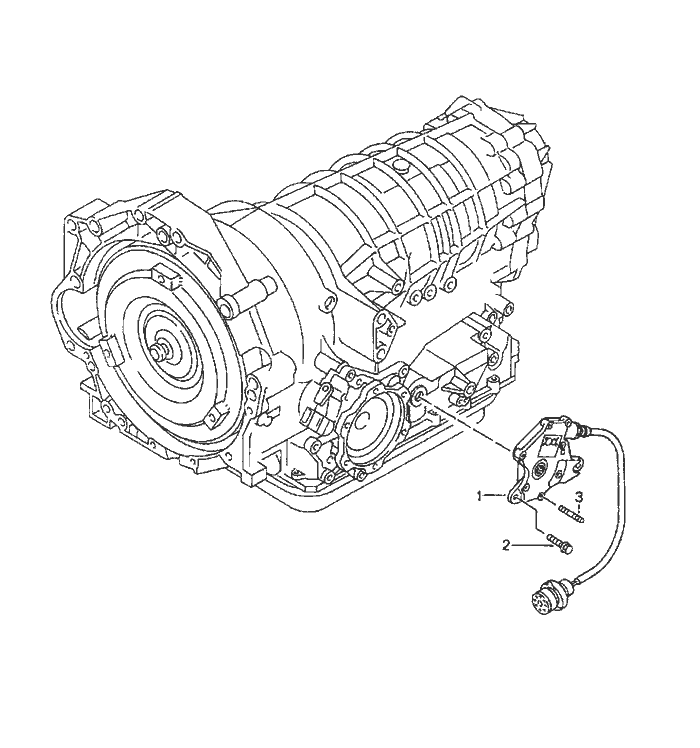

Jsebastian and otisdriftwood:
Here is a diagram showing the location of the neutral safety switch, a drawing of what it looks like and how it is attached:
