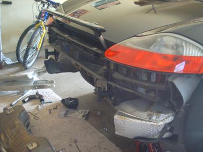

I will give this thing a try on the weekend... My concern with removing the bumper is the part where I need to remove the rear spoiler...
I will probably put the rear on stands to do the work - is that what you guys did?

It is quite easy to remove the rear bumper cover, as it gains you quite a bit of access to the upper mount. Rear spoiler comes off with a few simple plastic rivets which can be re-used.
