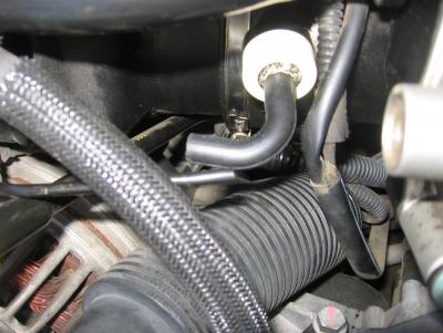

I had the same codes on my 02-996-C2-Cabbie. The line to the vacuum check valve at the resonance intake had dislodged as shown in picture and was a quick fix. But, the same thing happened again the very next day at 20 minutes into my drive. If it is holding vacuum, why would it pull apart? Should I suspect a bad check valve?, worn vacuum lines?, or check elsewhere? Or, should I just attach some hose clamps and see if that does it? Thanks for suggestions.
FYI-update. I have had no further incidents with this "dislodged" vacuum line. It was probably self-inflicted, accidentally loosened, and not securely enough replaced, after cleaning dried oil from the resonance intake. No clamps added or other action taken except to inspect rubber, "blow-through", and more firmly re-insert lines.
