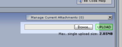

FYI you can upload images to this website which is great for future people who find our posts. That way if you took your personal photos of your web the links will not be invalid!

As far as the pictures, the picture that I took with my camera was too big. I will have to resize it next time.
