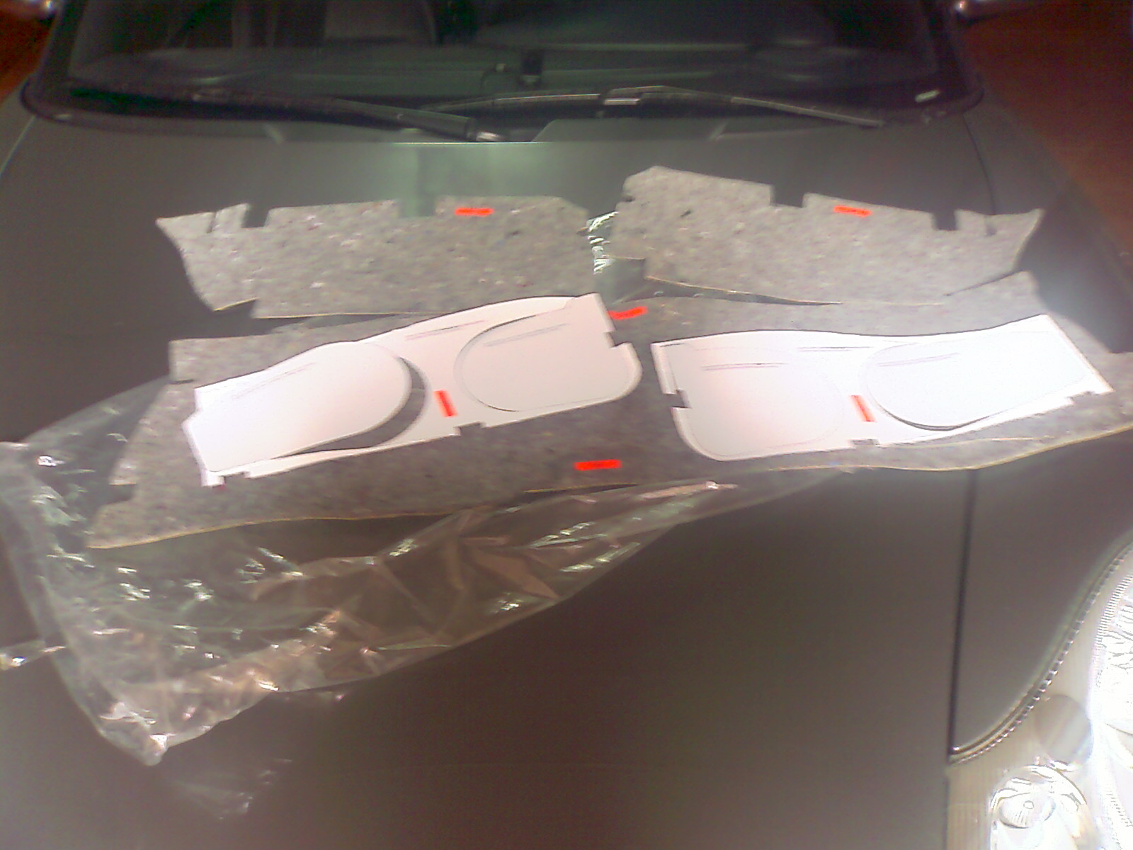

I was trying to install yesterday... I could only install the loudspeakers of the roof

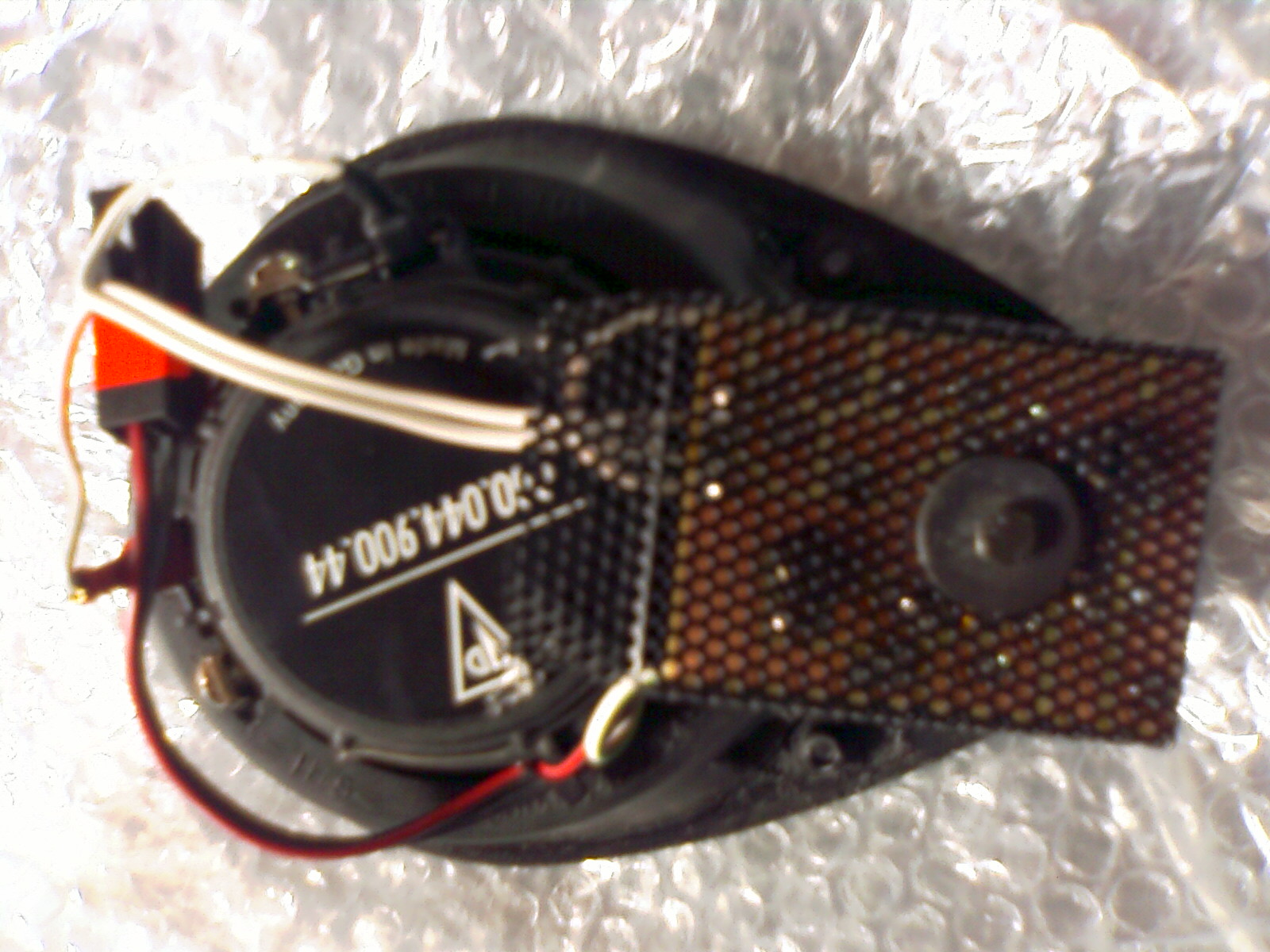

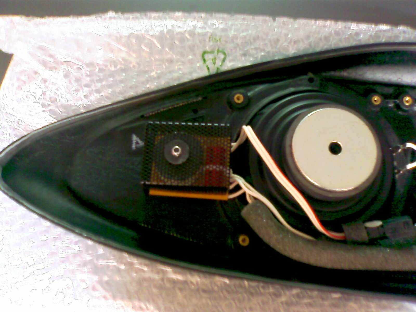

These loudspeakers seem of high quality and add clarity and brightness to the sound. The sound test with the rear standar loudspeakers (poor bass) improves significantly the clarity and espacialidad being absent obviously bass on not having been installed into front doors.
I have not dismantled the loudspeakers since they come sealed, but the components of the filter as well as the size of the magnets seem of high end. I don´t know what is the brand. The bass ones on the other hand it has cones of paper and standard magnet and dulling for what I am going to change them into others but first i´ll test it.

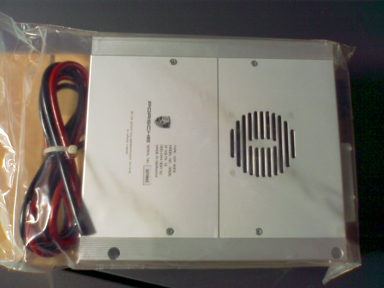

I have not installed still the amplifier since my car comes without the 490/680 option and have to wire up everything included the doors. I couldn´t found a conectors for the ampli...
The amplifier and the topology of construction seems of high quality, includes a ventilator since it works up to low impedance
I have been looking for all the sides for the esqueme and the conector of the amplifier but I do not manage to find it.
