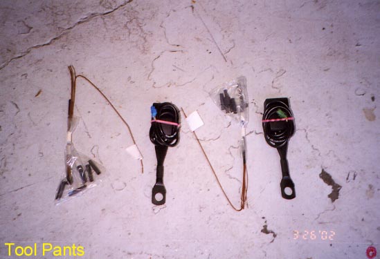

This is the kit. New buckles and ground wires depending on the year.
Thanks once again. Toolpants, in the event the dealer will not cover the expense for the repairs (I do have a Porsche extended warranty) and I choose to do the work myself are special tools required other than screwdrivers and wrenches.
I watched Peter at AB do it a few years ago. It is just soldering new ground wires and following the instructions. The only tool I can think of the the female torx socket to remove the seat bolts.
