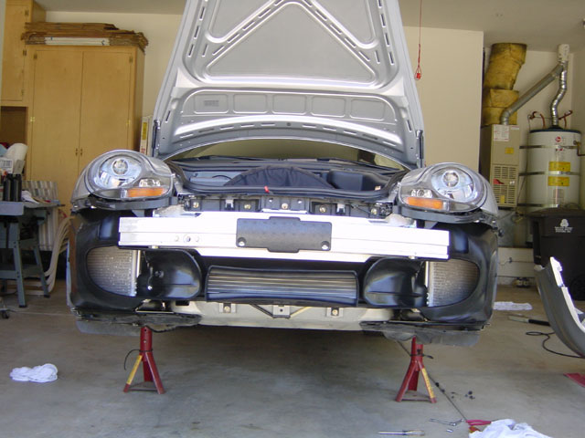

Put in third radiator but can't fit bumper back on.
Don't know how to align the two screw holes. See picture:
I have to really bend the bumper to align the two holes to the metal mount.
Once I get it to align, the rest of the mounting holes will mis-align.

If the bumper alignment is that far off something is wrong. Do you have a pic of the ducting (bumper off). It should look like the one in my DIY.
The radiator mount was aligned correctly.

Well, everything looks ok in the picture so you must be either getting hung up on the ducting or the damage to the bumper is causing the misalignment. These things fit pretty well so you bumper damage still may be the problem.

Can you post pictures of the bumper "in whole" so we can see its symetry.

The actual mis-alignment of the mounting holes was caused by mis-alignment of the radiators.
I have to loosen all mounting bolts for the radiators and push them up and before tighten them.
Now Its a perfect fit.
