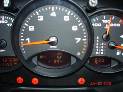

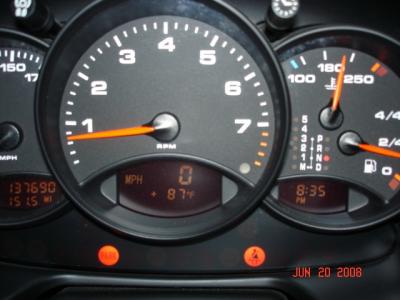

is my car running too hot ?
it was close to 90 degree here in orange county california today..
my 996 was running that hot with air on.
was it running too hot ???
i dont think there is porsche anitfreeze in the car, i think prestone antifreeze is in there.
137,000 miles
water pump was replaced
11/11/07 Water Pump and Thermostat 127500 Miles $417
thank you sir
no debris in the front ...
not having porsche antifreeze is ok ????
If you were in stop and go traffic then it looks about right. It should come down to 180 - 190 with speed.
You might want to make sure your radiators are clear of debris (leaves, paper, dead birds, etc.)
