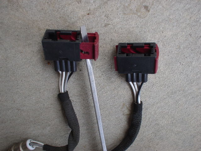

Need help!! I've been trying to pull my oxygen sensor off for half hour now and it seems that it is stuck from the connector. Is there a proper way or technique on how to remove it from the electrical connector? Thank you

thanks Derek but your connector is different than mine...
This is the connector for a 2.5. It has a slide lock. Stick the blade of a long thin screwdriver in and twist the screwdriver to slide the lock to the unlock position.
This is the connector for a 2.5. It has a slide lock. Stick the blade of a long thin screwdriver in and twist the screwdriver.
