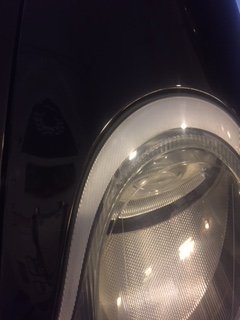

I have a 1999 996 Cabriolet with Halogen headlights. I live in Phoenix, AZ and noticed when waxing the car the rubber seal around the headlight that mates to the fender well is degraded and rubbing off (smearing).

I replaced the rubber seals on my headlights with the referenced steel product. It is definitely a generic product and does not fit like the factory seal. The edges on the original factory seal are rounded and it is formed to fit the curvature of the lights. The new rubber seal width also had to be trimmed a bit in places to allow the headlight to fit back into the body without excessive force. On a close inspection this retrofit does not look as good as the original, however it is far superior to the original once the original seal has degraded (mine was turning to goo). This product can also be easily removed should a better solution be found. There is probably a generic product out there that would be a better replacement but I didn't want to go through the trouble to discover it given that someone had already found a serviceable solution. Best of luck on your project!

The rubber is so goo-like that I use it's viscosity to mold or stretch it with my fingers and push it back to where it is supposed to go. Probably not what Dr Ferdinand would do, but it works.

996 Headlight Gasket repair ?  I have been searching for a fix for 3 years... and I think I have found a good replacement. See Photos below.
This hollow "P" shaped 1/4 inch tubing ( 1/2 inch overall width ) with a tape backing worked great on my 2000 C4. Ordered from McMASTER-CARR   https://www.mcmaster.com/ - "High Temp Rubber Seal" - Pt # 1129A992 "Style B".
https://www.mcmaster.com/#1129a992/=1e35sf5
A 5-foot section does one headlight with some left over. Two 5-foot rolls cost $19 plus shipping & tax. See the part number details in photo.
A few notes on installation. Clean all the old rubber "Goo" from the area with alcohol including the channel between the clear lens and the black headlight case. This new tubing flange will fit inside this channel. Insert it with the tape side facing away from the lens and as you work it around the lens remove the tape backing. It will stick to the channel and stay put without any other clamping. Run the tubing out about an inch beyond the lens and when you reinstall the Light assembly, tuck the extra tubing under the light between the fender.
Because this is hollow tubing it compresses very well as the light is installed in the fender. And if it bulges out any it is easily pushed back in place with a finger or a small plastic tool. It is Black but a bit shinier that the original which I could compare to my other lamp which is new having been replaced after damage.  Good luck returning your 996 to like new... :-)
