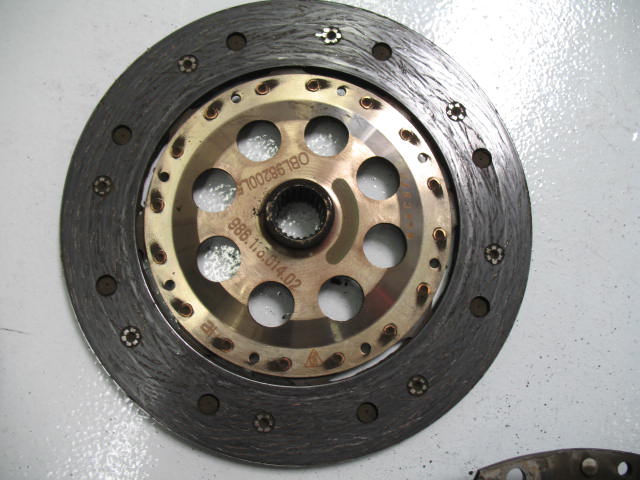

You look at the clutch disc to see how much friction material is left before the rivets are exposed. If you can, compare your disc next to a new one.
This is pressure plate side of my 1997 Boxster clutch disc with 67,000 miles and you can see some of the rivets were rubbing against the pressure plate.
Even though the clutch may still have some life in it , since the transaxle is off and everything past the flywheel needs to come off to get at the RMS, might as well do it. The labor should be absorbed by th RMS change.
