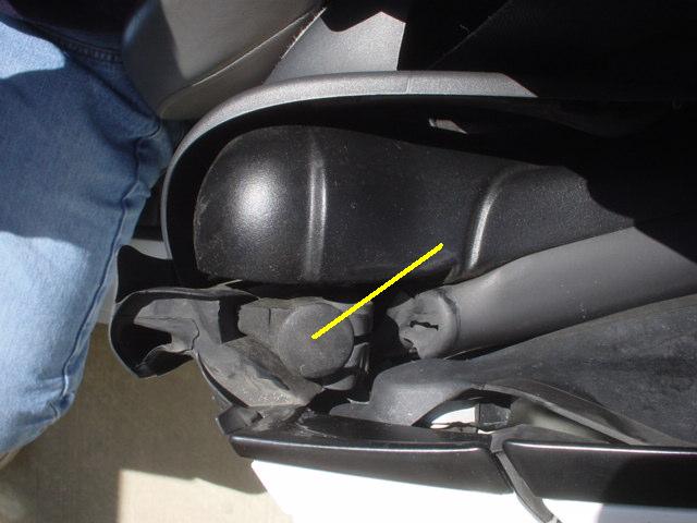

I don't think I want Dieter to work on my car. The 2 drain holes under the top do not have a plastic umbrella. The pic of the plastic 'umbrella' is the plug for the hole where the spinlocks go if you do not have spinlocks. When I see a car missing one I look under the top and I usually find it there - just like Dieter did. Somehow it flys out of the hole and ends up under the top.
The first pic is from their site with a yellow line to the 'umbrella.' The last picture is a local Boxster with a yellow line to the head of the plug stuck in the hole.

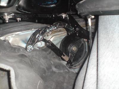

I have this water leakage through the broken holes at the liner foam, to my lucky ... I fix it with a water proof canvas (cut to size) and lie it under to channel the H2O to the drain holes ...
As attach you can clearly the water proof canvas ... :D
Good Luck ....

GTO:
From your photo, it is difficult to imagine how water that ends up on the rearmost surfaces of the foam liner would not find its way UNDER the canvas patch that you installed.
Wouldn't it make more sense to put the canvas patch itself underneath the foam liner, and seal it to the underside of the foam liner with some silicone adhesive sealant?
