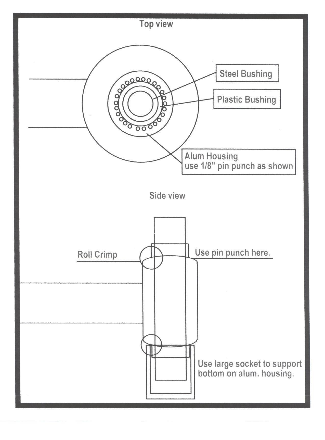

The replacement of the 986 rear control arm has been covered in previous treads. This post describes the possible REPAIR of the rear control arm. You might as well try it since you can allways by a new part if this fix does not work. First remove the control arm. Clean the control arm and remove the rubber gators covering the main bushing ( 2 ). Then support the bottom of the bushing housing with a large socket to where the only contact is on the bottom crimp. Then use a 1/8" flat punch and lightly dent the roll crimp around the entire circumfence to tighten the original crimp to take out the axial plat that causes the noise. Note that only ONE side needs this treatment. Lubricate the ball joint and reattach the protective rubber gators. Reinstall the control arm and test drive your quiet Boxster. I did this repair on my 2003 Boxster S last year, 3000 miles ago and it is still performing as new. Saved $ 600.00 in parts. :clapping: , Acomplish this repair at your own risk!post-21285-1212784861_thumb.jpg[

Remove the rear wheel. Then remove the Trailing Arm ( item 8 in the parts fiche ) by removing one M 14x 1.5 Nut and M14x1.5X75 mm bolt close to the wheel carrier and the second bolt M14x1.5x90 mm fastening the control arm to the car body. The nut in the upper part is fixed and the bolt can be removed by using a socket from the bottom. Then simply remove the Trailing Arm and repair per my instruction. Install by installing the bolt at the car body first and then use a 2nd jack to raise the wheel carrier to make the insertion of the 2nd bolt by the wheel carrier easier. Both bolts should be torqued to 118 ft-lb. Good luck and let us know how it works for you. Your wheel alignment should be ok.
