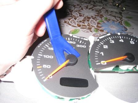

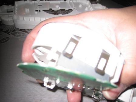

Hi Loren,
I was able to find the root cause of the problem; in fact the issue was a small rectangular part responsible to transmit the signal to the display. Talking with Birba Racing Company (www.birba.com) worldwide leader on Dials for Porsche, they told me that this plastic part in reality is a fiber....
I have also become now a specialist on dismount Instrument Cluster and change dials.
