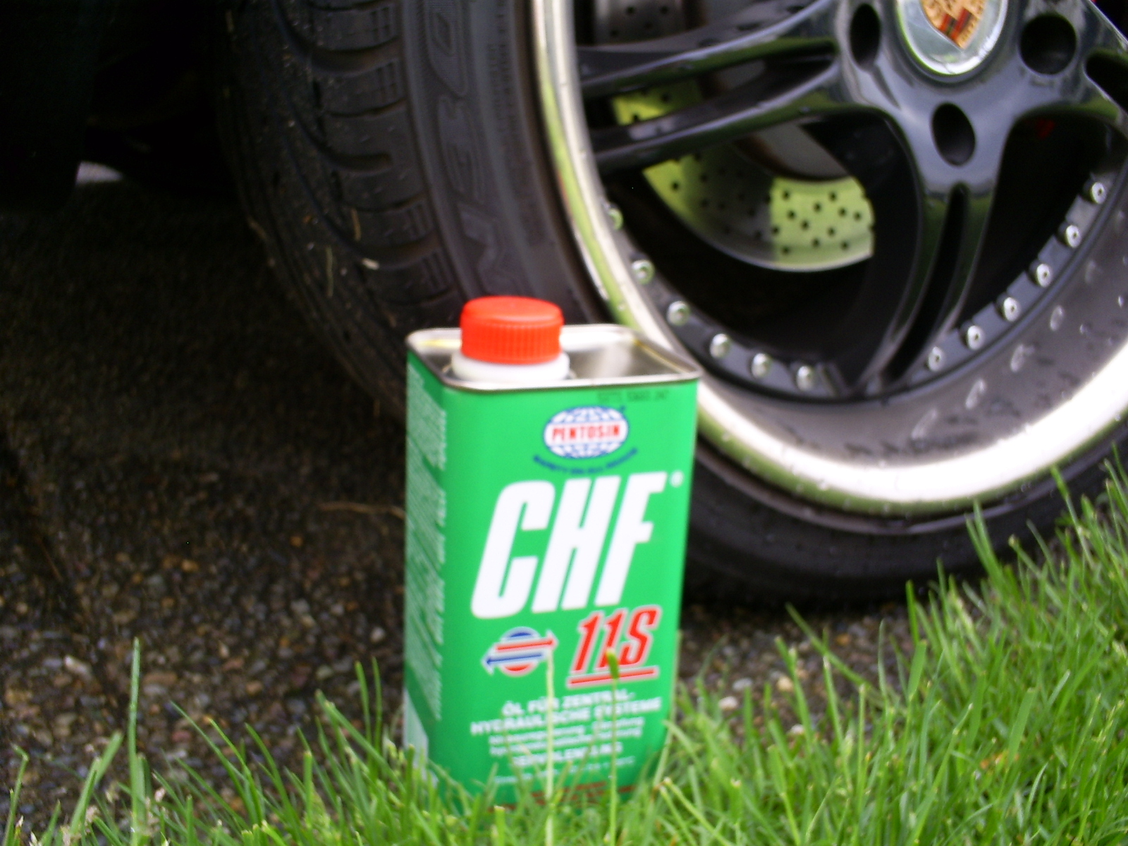

Question is do I have to use Pentosin? I'm assuming this is for the power steering, can't I use normal ATF ?

Don't use ATF. I, like some others, use Swepco 715. Though no one officially sanctions it, go to their web site and you'll see a looooong history of their association with Porsche Racing.
Cecile, a regular on PPBB, will back me up, he's been using it in his Porches for decades.
Regards, PK
