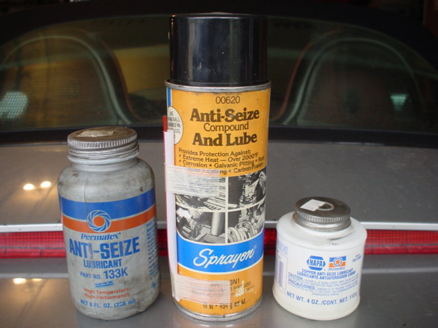

Thanks Loren. What would a good brand of anti-seize be from perhaps pep boys? I used some Molybdenum Disulfid grease - I assume that's not quite the right thing?

Anti-seize is a thin bodied grease. Then you get to mix in your flavor. Lead in the olden days. Copper. Nickel. Graphite. Bannana peels. Whatever.
