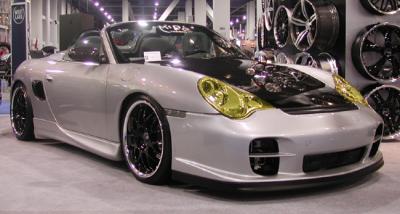

Hmmm that, actually looks really sharp, minus the yellow headlights. Not a fan of those. but the wheels looks good.
Yup that SILVER 986 looks pretty tight , I might have to say,,,
I've seen more than several SILVER 986/996'S w/black rims around. Obviously they all had a good taste + look very sharp.

I like the black vents on the back, and the black hood. Pretty sharp. I'm considering getting the body painted Orange instead of it's silver color now, kinda like the Special Editions Boxsters, and then having some of the inside interior accented in the orange as well. I figured it would look extra sharp.
