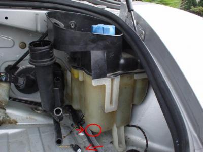

at the bottom of the expansion tank there is a sensor .... if that little sensor is faulty or perhaps the wiring.....it might trigger the blinking
The resovouir tank? Or the expansion tank? Is there a write-up on replacing this somewhere?
They are both the same thing.
The tank in the back trunk..... look at the picture
