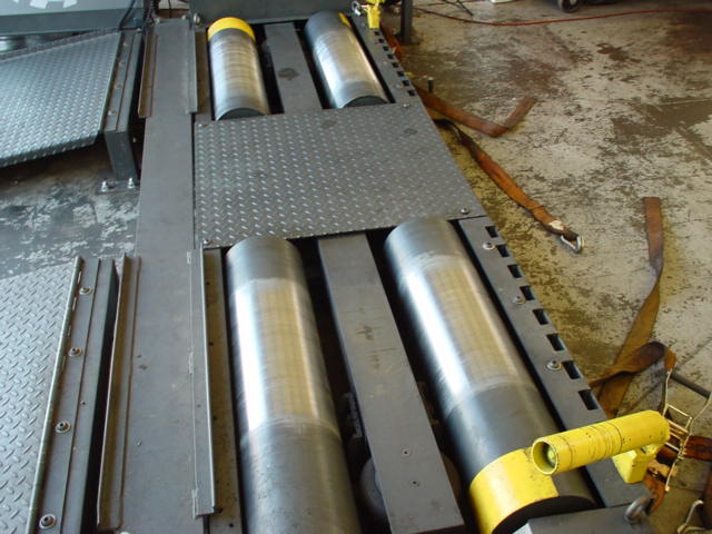

In the olden days the car sat still on the parking lot. Wheels never turned during the test.
Then the dyno thing came out. Before your rear tires rest in the dyno rollers, there is a bar in the front of the rollers. When you drive the car onto the rollers the tires push down on the bar which is a weight scale.
If you look at some recent smog inspection reports there is a line item for the test weight of the vehicle.
So if you tell the smog machine you have a 2,000 pound Elise for testing, but a 3,000 pound vehicle such as a Boxster just drove up on the rollers, you got a problem with Arnold.
Then if something went wrong during the test, such as the mechanic could not hold a steady speed during the test, then you backed the car off the rollers and started all over again. Why? Because to restart the test the vehicle needs to be weighed all over again.
The speed that needs to be held for the test is 15 mph and then again at 25 mph. This is not hard to do with a manual transmission. Problem is some vehicles have an automatic transmission and if it shifts to the next higher gear during the test the rpms drop or the speed changes, which means you cannot compete the test. Then you need to restart the test, and back the car off the rollers.
