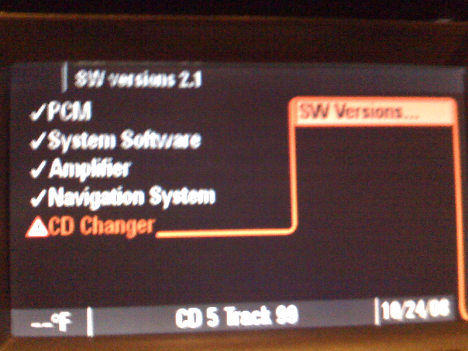

So if I push MAIN and TRIP and don't see CD, I'm out of luck as far as track names? Or is that just to check if the dealer has enabled it?
Also if the devices aren't connected in the right order would the Dension still work? I'm wondering if that has anything to do with it because mine still works but I'm not sure what order it was done in. Another thing that gets me is the fact that my setup works no matter what the dip switches are set to... Something is definitely wrong :(

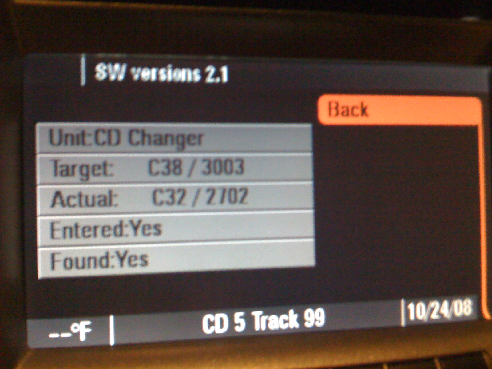

Here are my results from the MAIN and TRIP buttons...
It seems weird the target and actual are pointing to different places?
Strange. I have have nothing in target, only actual.
I notice that your PCM says version 2.1. This is an old software version so there could be an incompatability with the Dension?
You should be able to get the PCM up to version 3.0 (the dealer will have to do this for you).
I think you must have everything in the right order because it is all listed there.
