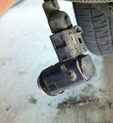

I have a 2005 Cayenne S. Rear Park Assist is not working. I was able to examine the "corner" sensors and they are both cracked. I was not able to check the middle four since I only took the lower valance off. I think its weird that the two sensor have so much damage. Please comment.
Do all years of Cayenne use the same sensor? The one on Ebay right now (user e-bacho) have different numbers than mine: 3D0919275D USD$39.90
I have also read sensors for VWs will work (saw it on ebay) and they are less expensive, True or False?

Yes, the sensors are the same.
Did you use Durametric or a Porsche PIWIS tester to verify the fault?
One of those testers will pinpoint the problem. Otherwise you are just guessing and likely buying the wrong parts.

Just got the same issue this weekend, pulled the rear bumper, checked all sensors, even removed all sensors and still had the 4 red leds for the rear coming on. all the wiring is good, no shorts or broken wires. Tested with durametric and got 1327, 1549, 1546, 1545. The last two are Short circuit to B+, but the wiring is good, now trying to find an easy way to test each sensor
Just a suggestion.. those look a lot like the sensors BMW uses. BMW ones actually make an audible noise when they're working. Sounds like a cricket chirping. It is VERY faint, and obviously the system has to be activated to hear it. The one not making the noise is the bad one. A mechanics stethoscope (Harbor Freight - $3.99, often on sale for $2.99) will probably help a bunch in hearing them.
