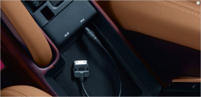

The new Tequipment Cayenne 5/2007 ( up to MY 2006) has a music player interface which is integrated to the center console storage compartment and enables an external music player ( iPod, MP3 player etc.) to be connected via the PCM or CDR-23 radio. Part no. 955 044 902 90. Anyone have this installed? Price? were can it be bought? :eek:

Here is the picture that is in the parts list.
There is also a "Operating Instructions Multimedia Interface" 997.044.901.74 that I assume is some sort of manual...
What is required to have to install just this part? where does it connect?
How does it work with the navigation PCM?

No worries NOT AVAILABLE ON US MODELS
SUNSET MOTORSPORTS QUOTED ME 387
The dealer here in Puerto Rico has ordered about 5 units to install.
I will get the quote on mine and post how much it will cost.
Watch out, it uses a hard wired FM modulation to hook into the audio system, you have to tune to a station to listen.
A little expensive for that type of solution when you can buy the parts for $30 except for the neat interface box
I have the installation instructions but they are 2.7Mb, larger than the attachment limit here of 2.05Mb.
The time quoted to install is 150TU which I understand means 1.5 hours.
It seems somewhat more sophisticated than the $30 kits referred to elsewhere and the FM tuning appears to happen automatically, not by "tuning into a station" as has been suggested.
