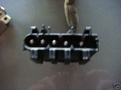

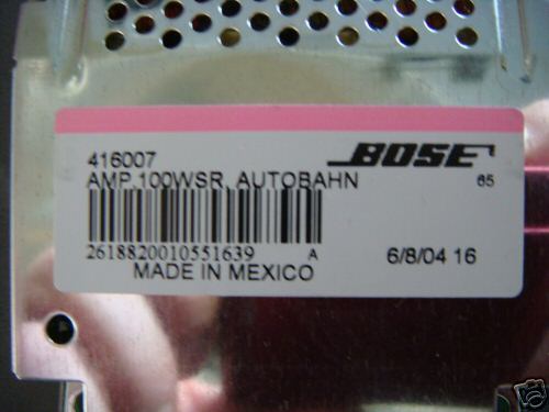

Hello, I am wiring this sub amp and speakers from a 997 into a Boxster and need to build a custom harness. The amp is the Bose Autobahn setup, with the 6 pin AMP connector. Can anyone help me by identifying the pins? Of the six pins only five are in use, connectinng to the amp via a twelve pin connector which plugs into the PCB.

The Bose amp configuraton on a boxster and 997 are different as there are fewer speakers in the Boxster. The amp is connected via the MOST (fiber optic) network cable to the head unit , it also needs to be the correct software/ firmware level to communicate propelry with the head unit. The head unit itself must be configured using the Porsche workshop tool to drive the MOST system BOSE amplifier. There have been a number of isues with BOSE amps locking up and not functioning as a result of PCM updates , so you are being very brave if you are transplanting a bose amp from a 997 into a 987. Personally I would check the part number on the bose amp on PET and see if it matches the BOSE amp option on the model year boxster you are trying to fit it to. I can only assme you are trying to add a 997 subwoofer in a 987 boxster that does not have Bose already fitted , and therefore you are adding your own amp , using the 997 BOSE amp or trying to get the porsche head unit to drive the sub directly , which I don't think it has the power to do.
Regarding the plug you show in your post. Assuming this is the plug to the subwoofer. The 5 terminations are :
A2 +signal from amp
A3 - Signal from amp
A4 Plus switched line from amp (white/ yellow wire)
A5 Ground connection (this is a brown wire)
A6 Power feed (this is a red/ brown wire)
They are in sequence from one end to the other on the plug , the colours should help you determine which way round it goes.
The boxster 987 sub uses a 9 wire subwoofer as it has the additional inputs of the rear left and right speaker outputs (+ and - signals) as well as those listed above for the 997 unit.
These are on pins
A8 RL+
A9 RL-
A10 RR+
A11 RR-
I do not beleive these pins are in numerical order on the 987 plug. I think they run in sequence :
4,10,11,3,2,8,9,5,6 As before the colours of the wires should help you determine which end is which.
The plug that goes into the amp itself from the main harness has more that 12 pin connections , more like 22 before you count the MOST fiber optics. The 997 uses 9 speakers not including the sub woofer so thats 14 connections to start (some are paired) , even before you consider power , ground and the comms line to the sub.
Edited by berty987
Wow! Thanks for your reply.
You are correct, I am trying to use the sub amp and speakers in the Boxster, taking the appropriate input from the head unit or Nokia amp (98 Boxster). I am installing the sub speakers in the rear compartment, between the rear speakers. I will be installing a level control to give me the ability to adjust the level of the sub relative to the rear speakers, and while I am at it I may add some small tweeters with their own level controls driven by the head unit.
I bench tested last night before I saw your post and confirmed the pin configuration you described.
I have one more question, is the input to the Bose sub amp line level or pre-amplified or speaker level. (High impedance or low?) When I hooked it up to a portable CD player it sounded a bit wimpy.
Thanks again!
Edited by ianmac
I don't know for sure , but my guess is that since the subwoofer has power , it is an active rather than passive unit. This would mean it takes a "pre out" signal and locally amplifies it to avoid interefence and distortion from over amplification. The 987 and 997 bose amps differ physically and in in configuration ( set by workshop tool in the main BOSE AMP) in that the 997 has a single dedicated subwoofer signal from the amp (+and -) whereas the 987 subwoofer takes both this signal and the rear speaker signals too. This is where you may have some difficulty , especially if you plan on using the BOSE amplifier module , since the amp will be set up for a 997 which has dedicated rear speakers. The boxster does not have separate rear speakers and is designed to take the rear speaker inputs into the bose sub. If you wire the equipment as it was installed in the 997 I cannot see you being able to use the BOSE amplifier , (I cannot see how you can connect a 997 configured BOSE amp to a '98 boxster head unit using MOST) so you would need to drive the sub directly from an external source via a suitable amp with croosover / low pass network. Assuming the SUB isn't a "smart device" if the power feed and signal levels are correct , it should work. Don't forget that the sub needs not only power but also the "wake up" signal to activate. This could be a volt free contact (to ground) or a power signal at low level (max 5v?) , again I'm only guessing. If you look at the Bose car audio website you can probably pick up the extra info you need by looking at the aftermarket stuff. It's probaly all the same operation regarding how it's powered.

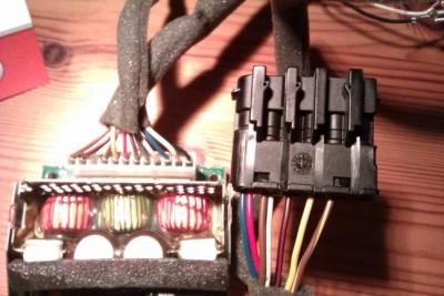

Hi,
i have the same problem as "ianmac". But i want to run the amp in a different car withou a PCM2. I´m not sure if this is possible.
The colours of the cables are differnt to mine. Maybe someone can help me, see the attached pictutes below.
Thanks al lot!
