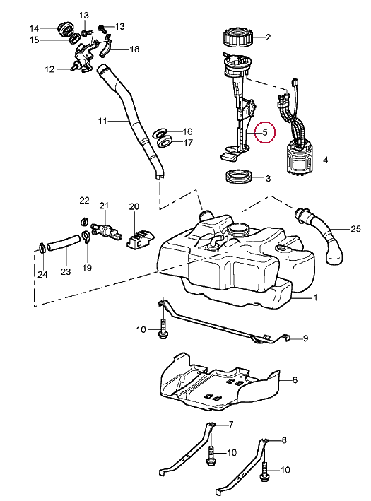

Loren,
Is the fuel level sender underneath the "service hatch" square thing in the middle of the trunk area?
Thanks.
Item 5 is the level sender
remove the battery and battery tray to expose a black cover plate fixed on by M8 bolts i think? four of them. under that plate is the fuel tank sender unit. unscrew the collar and remove sender.
mmmm...That part with it's giant screw on collar is located underneath the "service hatch" on my car. No battery removal required. I think?
Turbo and C4/s in the trunk under the trim in front of the battery, C2 under the battery.

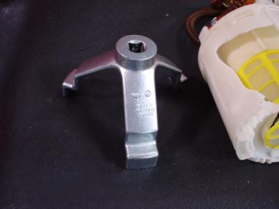

So how do you get that giant "nut" loose? Some gorilla must have put mine on because it ain't budging. Way too big for any wrench that I am aware of. Of course I don't want to break it as it probably cost $500 for that hunk of plastic.
Thanks again.
VW special tool 3217
Had a feeling you might say something like that :)
Are there any alternatives to that "special tool"?
Boxster guy said he got the locking ring off with a screwdriver.
Not sure I want to go the "screwdriver" route. I was looking at one of those rubber strap wrenches. I'll let you guys know if that works.
