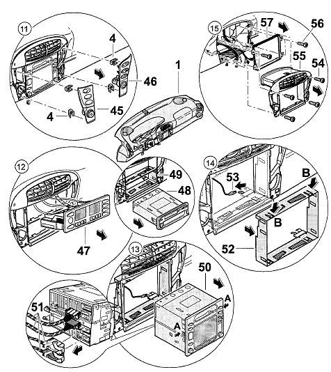

I am not sure about your question... If you mean the plastic pieces that surround the radio, climate controls, PCM, etc. then yes. The top plastic piece is one part and each of the two side pieces can be changed.
But the question is, I believe, is the PCM and regular upper center consoles the same. I think the inside mounting attachment points (where the PCM or AC/radio attach) are specific to either PCM or "other".
Mark
PCM and non PCM are different. The top pic is non PCM and the bottom is PCM. Non PCM has a cross bar. PCM does not as the unit is so large. If you do not have PCM then do not buy one for PCM. Jeff

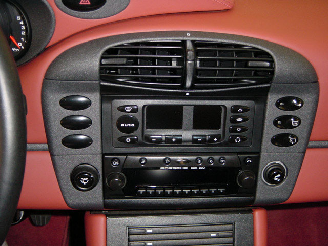

Im even more confused now. I am looking at the grey sparkly upside down U which I want to change. This seems to be 3 pieces. It looks like Lorens pic. Will I be able to swap it for a newer one piece burr wood upside down U.
I ask this because of one of the posts I have just read in this forum asking something similar (by ESK). The photo someone has posted shows a non-PCM plastic piece being removed from the center that looks remarkably similar to the piece I want to buy. The only difference is that this is one whole piece.
Please help me.........
The one piece upside down "U" trim started in 2002 on the 996, and in 2003 on the Boxster which is shown in my picture. It will not work with the older cars and has nothing to do with PCM or non PCM - it just will not fit. Jeff
