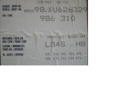

I should have mentioned that I have checked all the available places, VIN, option sticker, ect and it does not show that I have anything other than standard. although some of the codes come back blank from the options decoder here.post-24494-1210699160_thumb.jpg I have found little things that were hacked by the PO, i.e., Short Shift and Daytime running lights. I have a problem with driveways; they seem to be too high for the Aerokit front bumper cover. What I am wondering is, did the car get lowered or is the bumper that low.The front bumber ground clearance at the center is 5 5/8" and the clearance at the front jack point is 5 1/4". I'm not sure if that will help. I can see some parts tags on components under the car and that has piqued my couriousity as to what suspension I have. I hope that all made sense???? :huh:
