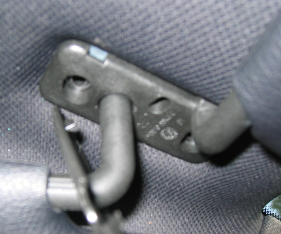

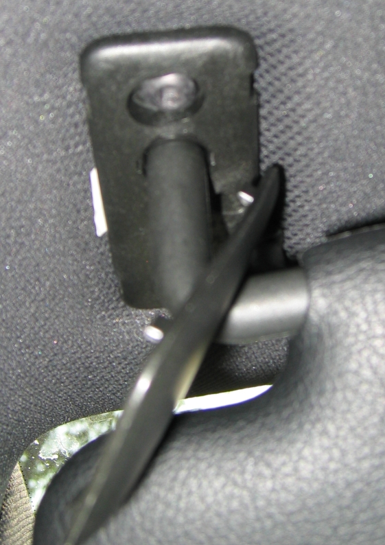

Thanks Loren. The cover just comes off with my finger and I see the 2 fastening screws. They come out with a T25
Then I'm looking at this:
I have the double sun visor where one piece pivots to the side, and the other flips up and down Boxster style. After unscrewing the two fastening screws (part 8), the sun visor still seems attached to something in the headliner.
Do I have to take off both the swing pivot side (toward the outside of the car) as shown in your instructions and the inside with the flip up-down visor? Or something else not too obvious to me? Even if I have to unscrew the other side, it still seems like the piece under cover (7) is still attached as the whole headliner moves up and down when I pull on the pivot
