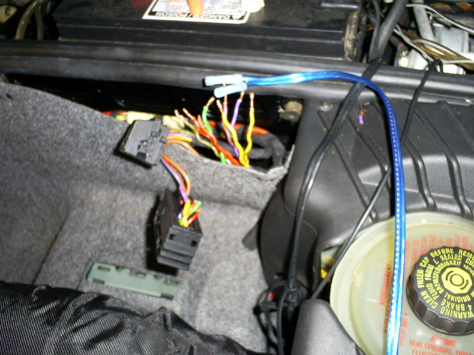

I ve hard wired it, also posted enogugh pictures.

As cassie listed larger plug is the speaker out hardness, they are twisted in 4 pairs - the ones with stripes is your negative.
Since U pm'ed me I thought to post this pix. green,purple,yellow,orange I belive,,,
