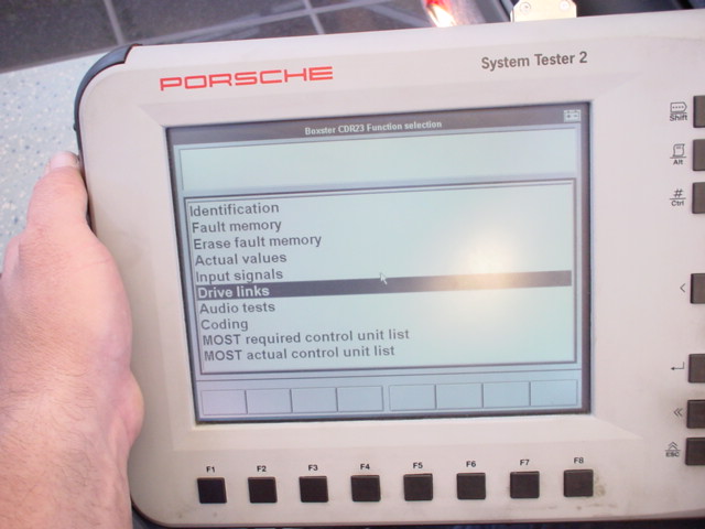

Try the Becker board. If you take all the MOST components out then it should be like any other car, except I think there is an issue with the ignition trigger line and maybe the a/c display. Karl on this board went through some of this. I would have to ask Peter if you can turn off MOST with the PST2.
