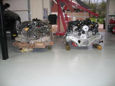

PLEASE PLEASE take some documenting pics of the engine being installed!!! I'd really love to see them!! Heck, if you were anywhere near me, I'd help you install it!
Will do... It's going to be a couple more weeks before I can get it back in (waiting on some parts). After reading some posts recently.. I've deceided to replace the slave cylinder and shifter fork assy while I'm there.
