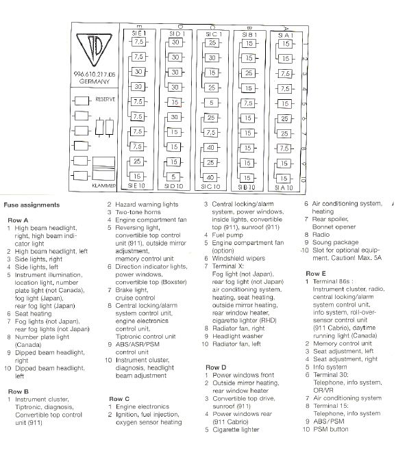

I have a 2002TT, I recently reversed the cables when installing a new battery:( Cost me a Grand to get a new alternator. I had an oil change done also. I now notice that I have a oil level failure on my display. I need to know what that is caused by, does anyone know? Also some fuses are missing on the fuse panel. Where can I find where certain fuses go on my car, there is nothing in the manual, nor on the back of the panel???? Plz Help!!!
