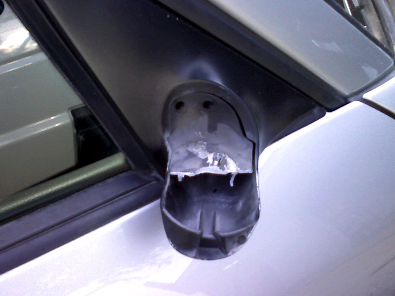

Did you ever get a response to this? I just had both of my mirrors stolen (broken off at the bracket). I need to figure out how to take this apart to replace the bracket and mirror.
Thanks......darryl
That sux - sorry to hear :(
Anyhow, if you pop the inside triangle "sail" piece off, there should be 2 (IIRC) screws holding it from the inside.
To pop the sail, use a small screwdriver or panel puller and pry it from the bottom gently about 1/2 an inch (take care to protect the door leather trim w/ a towel or such). Once it pops free (about 1/2" or so), wiggle it up to slide it off completely.
