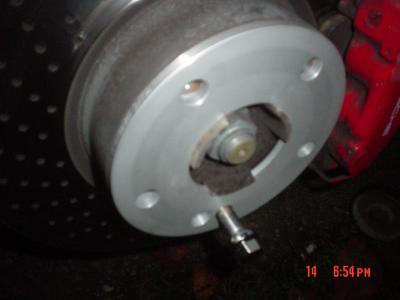

I'm planning to add wheel spacers to my front and back wheels. Has anyone had used either the H&R Trak+ wheel spacers or the Weltmeister Turbo Star spacers? Any preferences?
I have a set of H & R Track+ all the way around. Weltmeister is pretty cheap but they aren't going to be hub-centric.

What sizes do you have on your vehicle (in the picture)? I'm thinking 18 or 23 on the back with my stock rims.
7mm front, 18mm back
U will need a set of longer bolts all the way around.
