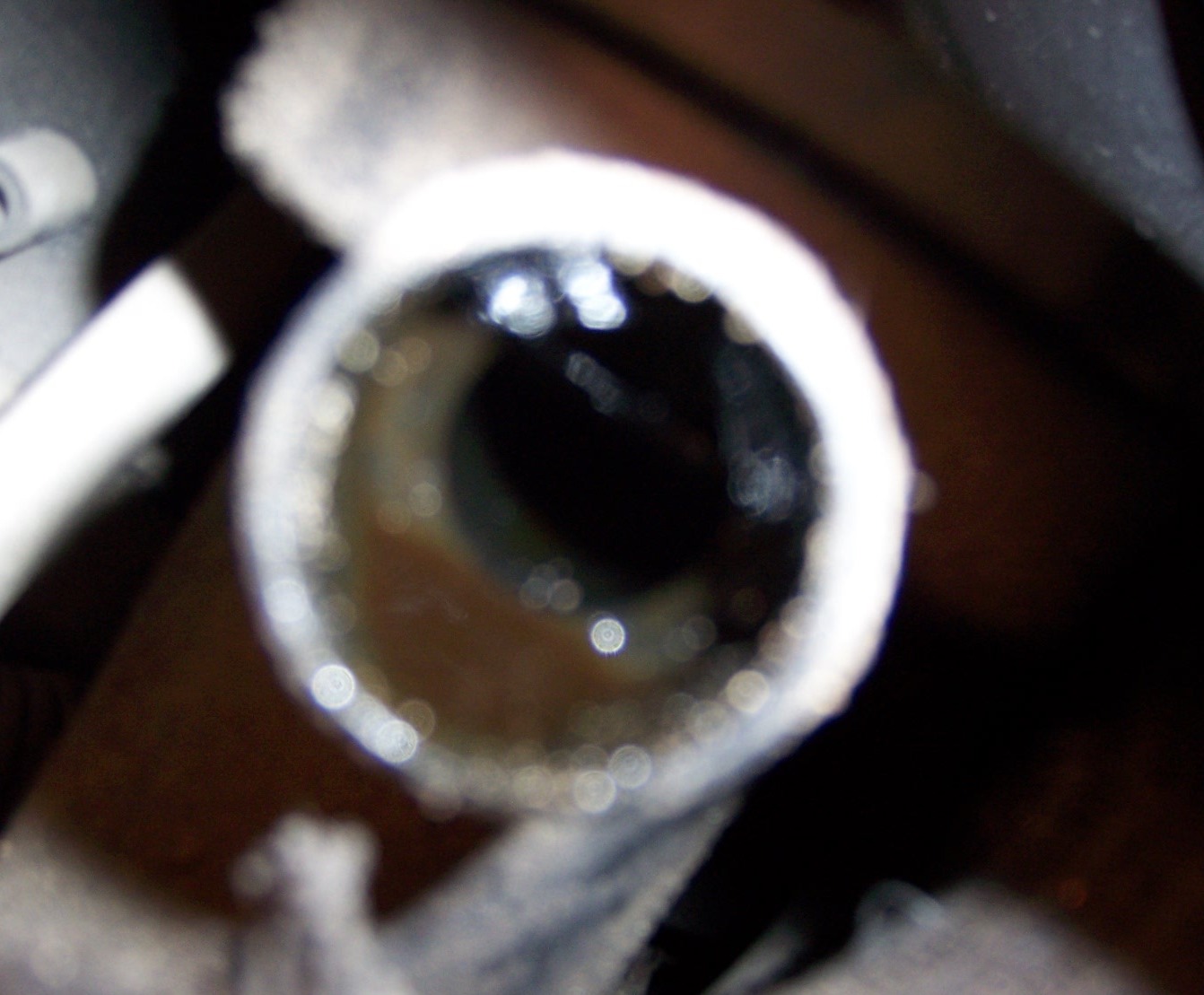

There didn't seem to be an excessive amount of oil in the J tube or in the tube connectors on both sides, stuck my finger in all, there was some, but definitely more of a mist then soaking or dripping, at least to my untrained eye.
There were I'd say 4-5 drops worth, a few millimeters deep, in the J tube on the throttle body end, and about 3-4 drops in the tube fitting part of the AOS piece.

Drops at hose/tube edge
A few drops at hose/tube edge
Finger swipe in one side of hose, only mist
Definitely the old version, needs replacement
