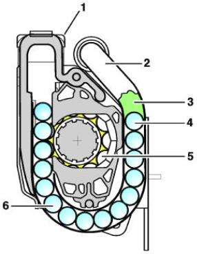

DO NOT try to take apart a MY02 or newer seat belt - there are pyrotechnic ball belt tensioners in these units. There is a great chance of injury if you try to take them apart.
1 Ball arrester
2 Tube with propellant charge
3 Gas pressure
4 Pistons
5 Pinion
6 Mass body (balls)
