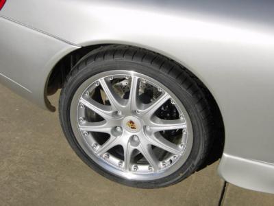

Are you sure factory spec is 32/36? I have 18" Porsche Sport Design wheels and the manual says 36/44. I wouldn't expect your 2003 model to be that different. The 32/36 in my manual is for 17" rims.
