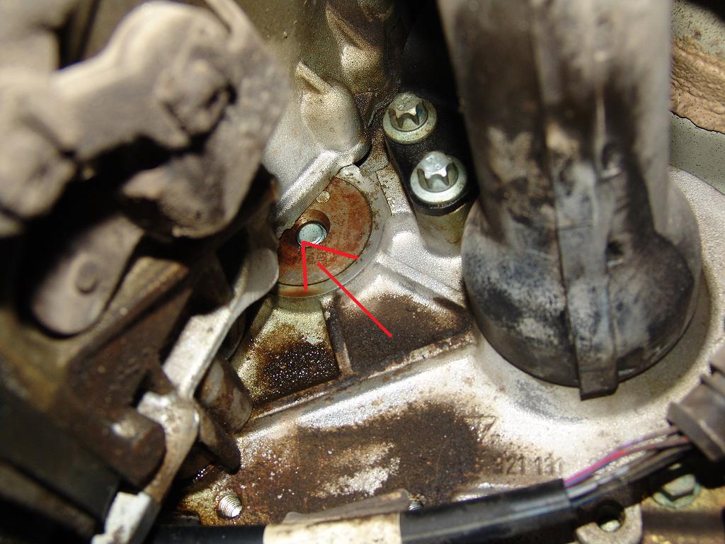

the porsche dealer said to me something else and when i went to a friend service they saw that is coming form another part !
in my area there are non transmission rebuilding shops ! :(
my friends from the service don't what to "open" the gearbox because they don't have the scheme of the tranny
from where ?? is from the transfer, the pictures is showing the transfer case and the gearbox, and the leaking is between the 2

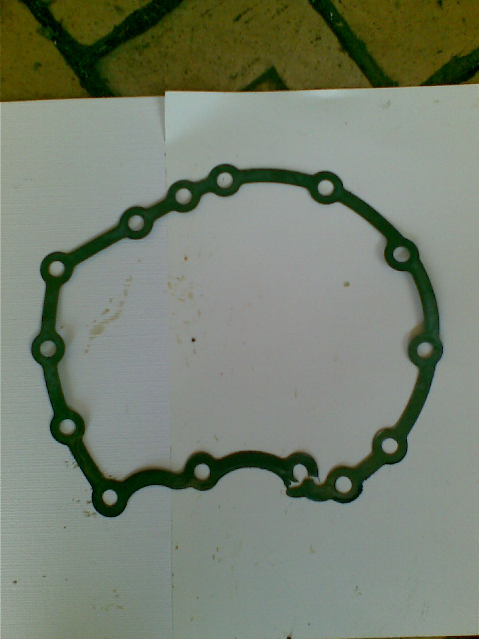

this one was my problem and is not the one that i post the first time...
the converter has 2 seals one in front and one in the back (near the gearbox)
