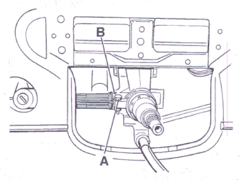

I have removed the small bolt where the lock assembly joins the steering column. The lock assembly is loose but will not pull out of the steering column. What have I missed?

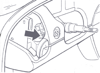

Detach support of steering lock on the assembly (arrow). The support is fastened with a screw.
The AC side vent must be removed to allow access to this screw.
Undo steering lock fastening screw A.
Unlock steering lock on the steering column (press spring-loaded pin B with a scriber) and simultaneously pull the steering lock out of the steering column.

Loren, an old post, but I'm looking to remove the steering lock and having trouble getting the spring loaded pin to move... am I missing something, or is it just under very heavy tension? Comments would be appreciated. he workshop manual is no clearer on the procedure. Help, please. Thanks, Lennie
Never mind! Figured it out - make sure the steering wheel lock is DISENGAGED! (insert key in ignition, turn to position 1 "run", jiggle the wheel to unlock - and presto).
