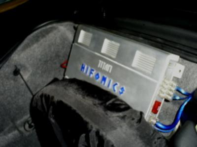

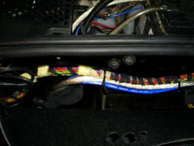

Hey thorman that would be very easy,,,notice where my Hi fonics Ampis located? Pull the carpet behind of it, you will see a rubber plug hole!

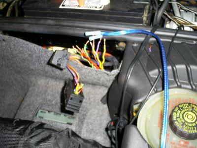

On the 3rd pic, you will my battery & how my #2AWG power wire is ran. This mightbe able to help U.
Edited by juniinc
Thank you, I did it that way!
However, this was not a blind plug in my car. There run cables for the Litronic/Xenon lights regulation! But there was still enough space.
Thanks again!
