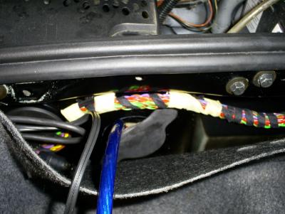

I retrofitted door speakers to my car which only had the base audio pack.
Its a pain in the hoop. The way I did it was to feed the speaker wire through the existing cable tidy from inside the cabin, enlarge the hole in the connector and feed it through both sets of connectors (instead or using the pins which Porsche says you should in it technical bulletin) and feed the wires again up through the cable tidy into the doors. It does mean, however, if they want to take the door off, the speaker wire needs to be pulled all the way back through.
To get the wires through the firewall, there is a rubber grommet just behind the battery that you can pierce and feed the wires through there. Make sure to seal it up again using some silicone sealant or you might get wet feet!

Thanks Davej, I found the rubber grommet behind the battery and have threaded everything thorugh it. I havent tackled threading 12 gauge too the doors yet though.
