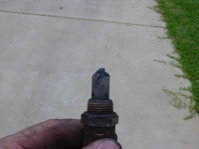

Well, I checked all O2 sensors and one was dead (see pic) driver side after Kat.
Put a new one in but the probelm is still present.

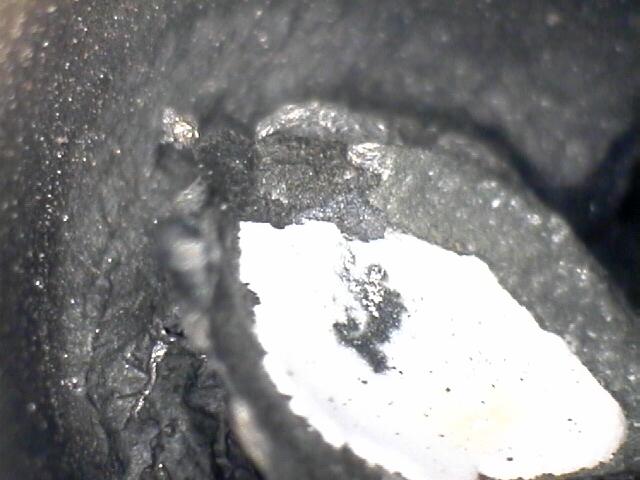

I'm not sure what happened - it almost looks like it got hit by something and left some sort of deposit and a hole. I have more pictures (macros) if you like to see then let me know.

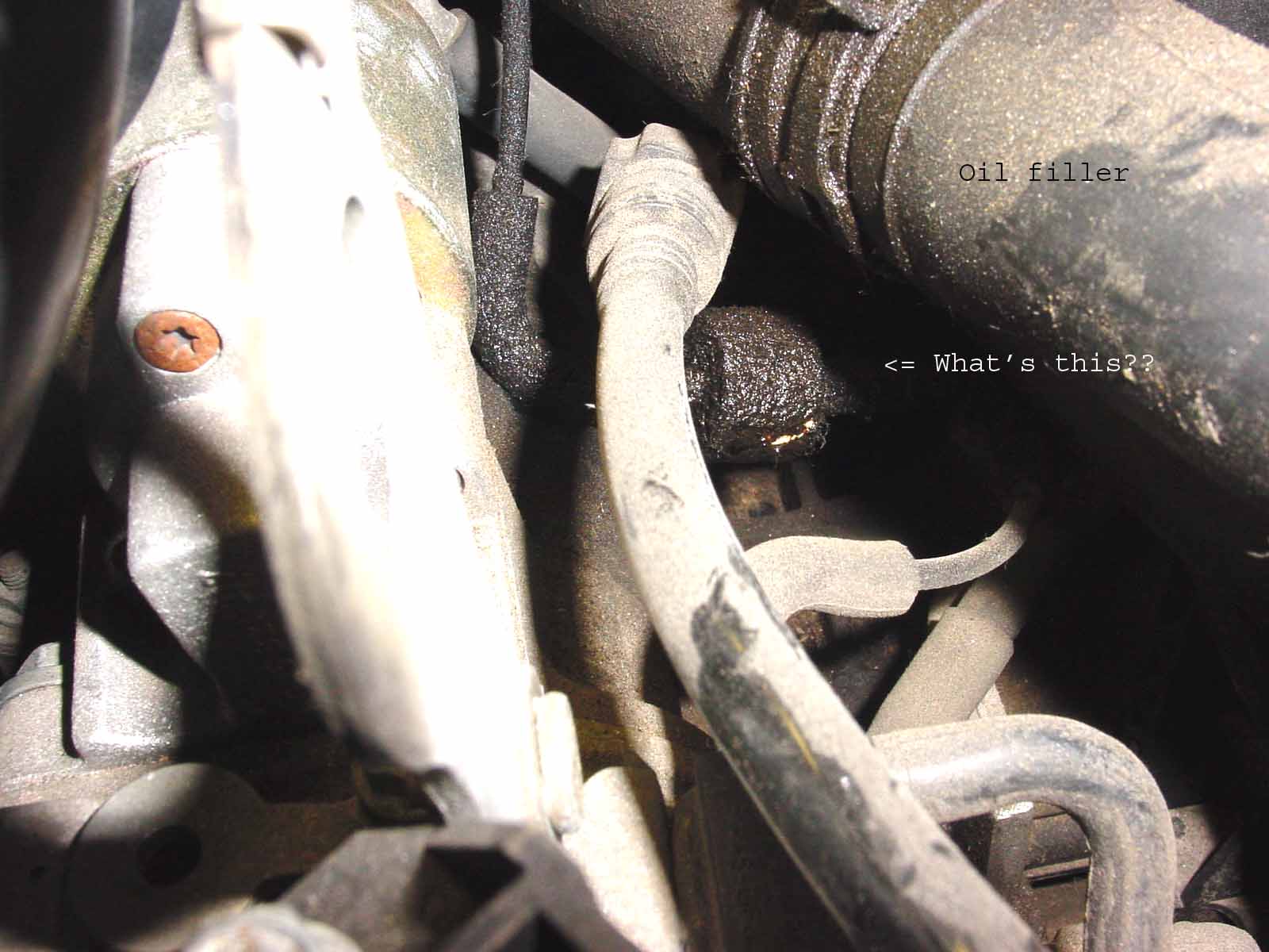

I just checked the oil filler ( see pic ) - there is a oil leakage and oil is dripping on some vacuum lines and something I don't know.
Can you identify the part for me - is that the root cause of my probelms?
The oil filler is not chracked like in the TSB - it is "just a bad connection".

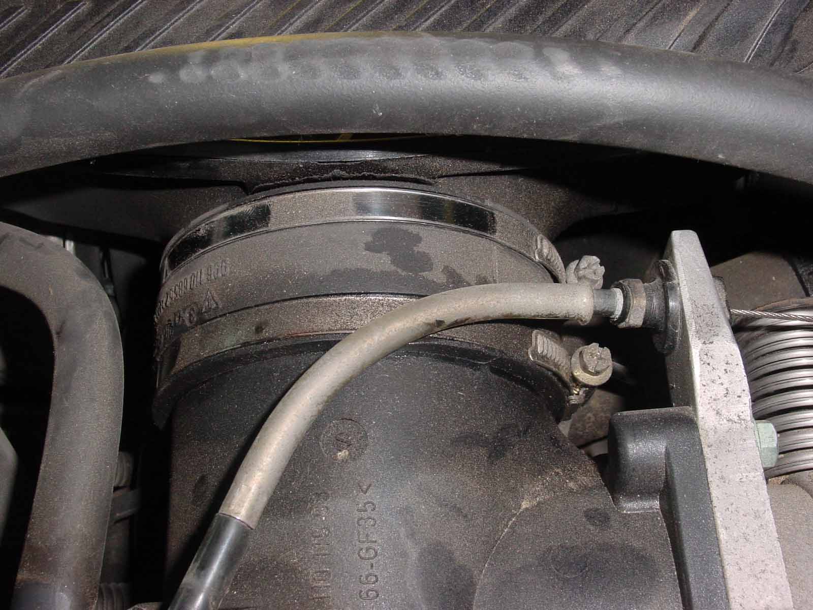

Just one more picture - found that the clamps where lose, actually not tight at all.
Hope that's it.
