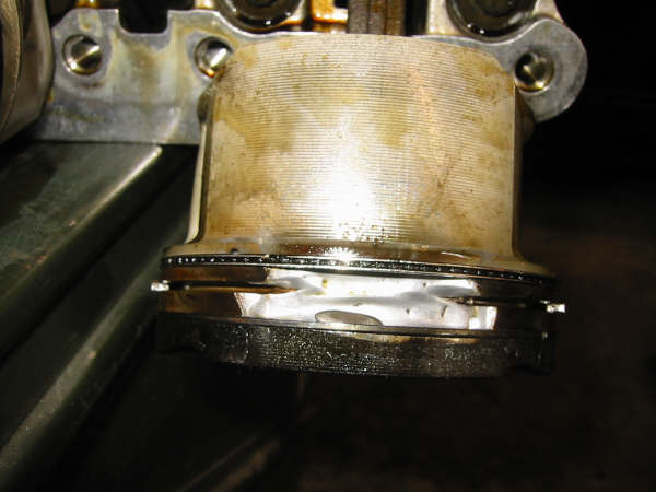

My buddy just bought a 97 with a blown motor and we have been toying the idea with a bigger motor.
But for now to get it running i think we are going to get a 2.5l and go from there.
www.car-part.com has a great network. Just a 2.5l longblock you can get for $1000.00. Cheap. If you just
want to get the car going again. Don't expect a warranty.
Aside from that any idea on how a piston breaks like this one?
Edited by seafeye
