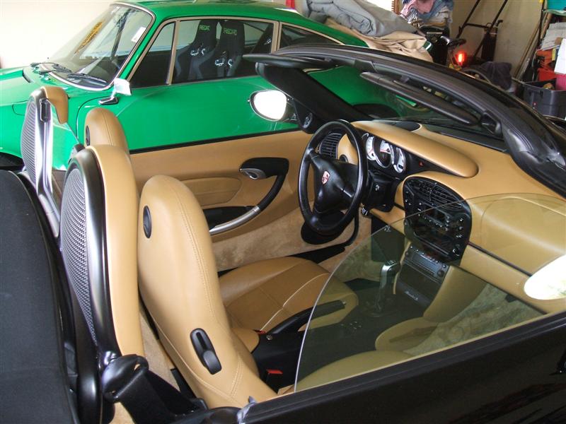

Was looking for a nice red/tan S myself a couple years back. I've owned numerous black/black or red/black 911s and wanted something a little different for a change and knew a black interior would not be best with a cabriolet. Well, got part of my wish with Savana interior, but ended up black again on the outside! Have a great time with your new ride and enjoy it every chance you get.
