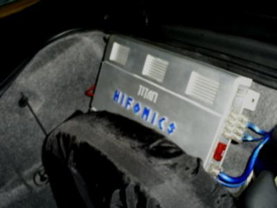

Yes, I have that sorry Nokia 4x40 amp. This amp should fit right into the OEM location in the front trunk with a small modification to the existing bracket that holds it in place. Once you get in there, it may not need to be modified at all... As far as the plugs, here's what you do.
1. Put the keys into the left and right slots on the head unit to unlock the radio and pull it out.
2. Unhook the existing harness that's plugged into the back of the Becker.
3. Then, plug the $9.99 Crutchfield harness into the back of the Becker where you just unplugged the factory one.
4. Then take the factory harness and plug it into the other end of the $9.99 Crutchfield harness
5. Then hook the plugs from the extension harness into the other plugs on the $9.99 Crutchfield harness, then plug all the remaining ones on the other end into the new amp.
That's really all there is to it.... I've just got to find out how to get through that **** firewall with the extension harness so I can plug it into the amp. Once I get around to doing it, I'll take pics and post a DIY.

OK.. I've ordered the Blaupunkt THA475pnp amp. Got it for $249 online at OnlineStereos.com (Best Deal out there) Ordered the T-Harness (that's compatible with the Boxsters) and the harness extension from Crutchfield. T- Harness is 9.99 and extension is 54.99 but you need both to mount the 475 in the factory location. The T-harness is on backorder so it may be a few weeks before I receive it. When I do, I'll take pics during the install and post on here for anyone who is thinking of upgrading their sorry factory amp. :cheers:

Actually, no... After some discussion with the tech guys at Crutchfield, they told me that Blaupunkt amp had way too much power and would blow those Alpines I already installed in the dash and doors. So I sent it back. Now, I'm going to order the four channel Alpine amp (F250) which pushes 40 watts by 4 channels, plenty enough to drive the 4" dash and 5 1/4" door speakers. So, it's still a work in progress.... Will take pics and document the install when I get around to it... :cheers:
