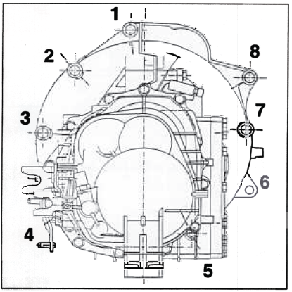

I am looking to do a clutch job on my 2000 996 C2 and it seems like kbrandsma knows what he's doing.
I have two concerns:
- Without a lift, how high of a clearance would you need to do this job on jack stands?
- The special 3 square 10 mm bolt. Which one is it? Can you indicate it on the attached picture of the G36 transmission?
Thanks, Joost

the triple square is no. 4.
The jack stands were about 16.25 inches. See attached photo of the jack stand mod.
The higher the better. I did mine with half the distance george996 suggests. Also #5 is removed from the front of the car, just the opposite of the other seven. I removed number 1 from up above. To get to #1, I removed the tube from the air filter to the TB and that made #1 very accessible and easy to remove.
I purchased the 10mm trible square from Autozone, brand name OEM. It comes with a set of three, 10mm, 12mm, and 14mm. I took the 10mm to a local muffler shop and they cut it in half to get it down to a length that would fit. The space is tight around the 10mm triplesquare bolt. SOme people permanently weld a wrench to gain the leverage needed.
