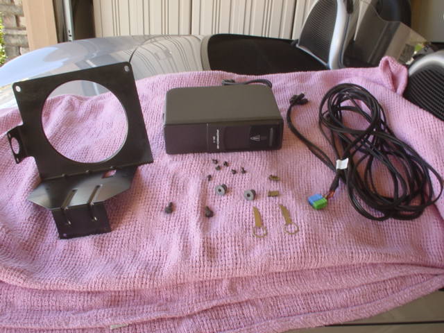

Does the cable you have look like my pictures?
You can get a Becker cable and mounting bracket from Porsche or Continential Imports.

If you get the mounting bracket from Continential they know all the other little parts you need. 2 clips 999 507 532 02. 6 screws 900 075 440 07. 2 well nuts 999 500 078 00. 2 bolts 900 378 179 09. You have the part number for the bracket. You also need the keys to pull the radio head.
The Porsche part number is 993 645 453 00. I think the Becker part number is 1184.709-276 - you need to verify. All you have to tell Becker or Continential is that you want a Silverstone cd changer cable.
The Becker cable is 17' long. We coil the excess and hide it next to the battery.
