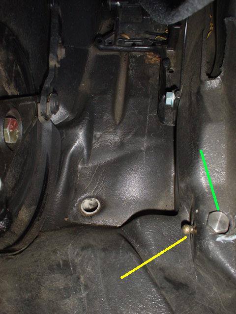

You can tighten the tension cables and see if that helps. It is the cables covered in black plastic with a ball joint on each end.
There is a green line to the adjustment bolt which is a silver color. You turn it counter clockwise to tighten the cable. The cable has been disconnected in the piture. The male part of the ball joint for the cable connector has a yellow line to it.
The picture is the left side of the car. The right side is identical.
