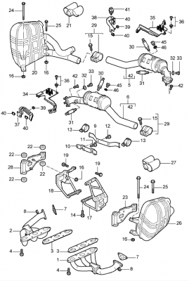

I feel a bit stupid. Tried to remove the one of the mufflers on my carrera S. When i remove the nuts, I can't get the bolt out. The bolt hits the chassis of the car. What am I doing wrong? Does somebody perhaps have the instructions on how to do this?

Which bolt?
If you are removing item 24 or 25 you are doing it the hard way.
Remove the three 13 mm nuts instead (item 16) that hold bracket item 28.
Much easier IMHO.

Hi has anyone got this info. Im taking the mufflers of next weekend and id would have gone for bolts 24 and 25 if not told otherwise
