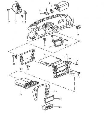

ok i ve find a picture of the "iron who's attached with the cup holder it n°20 than i ve in my boxster ( if i cut it a think its no good) i hope you understand .
i put a picture of the same but on the 2002 boxster

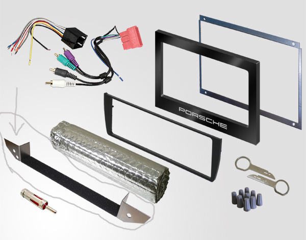

Alex,
The picture you attached on the right hand side (the old radio support bracket), you do not need that piece any longer. Instead, use the new bracket provided in the kit you bought. You may want to take at look at the directions in this thread. PM me or email me at cvt929@yahoo.com
