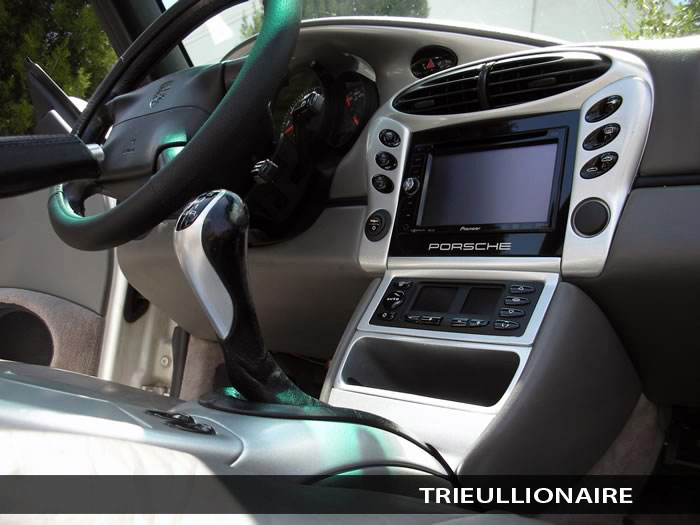

What if the heater/AC controls are above the radio? Can they be moved down like it shows in the pictures on ebay, and if so, how hard is it?
Thank you,
Brian
The climate control is actually designed to fit the lower of the two compartment (the compartment right above the bat wing). It slides in easy and is made to fit perfectly there, I was very tempted to go this route because all you need to do is bring the wires down and slide climate control right in and put on a trim piece.
But yes, you can move the climate control to the same spot as in the picture. It requires some work though and might not be the easiest thing to do as you will need to modify the space to insert your climate control there. The outcome though is better ergonomics, its more accessible and completely visible since your gear lever shouldn't be in the way.

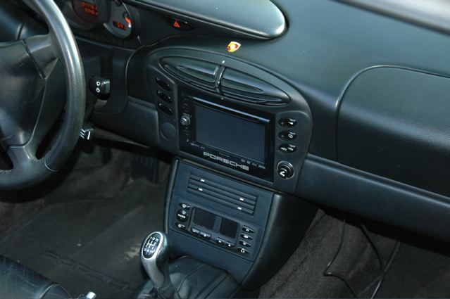

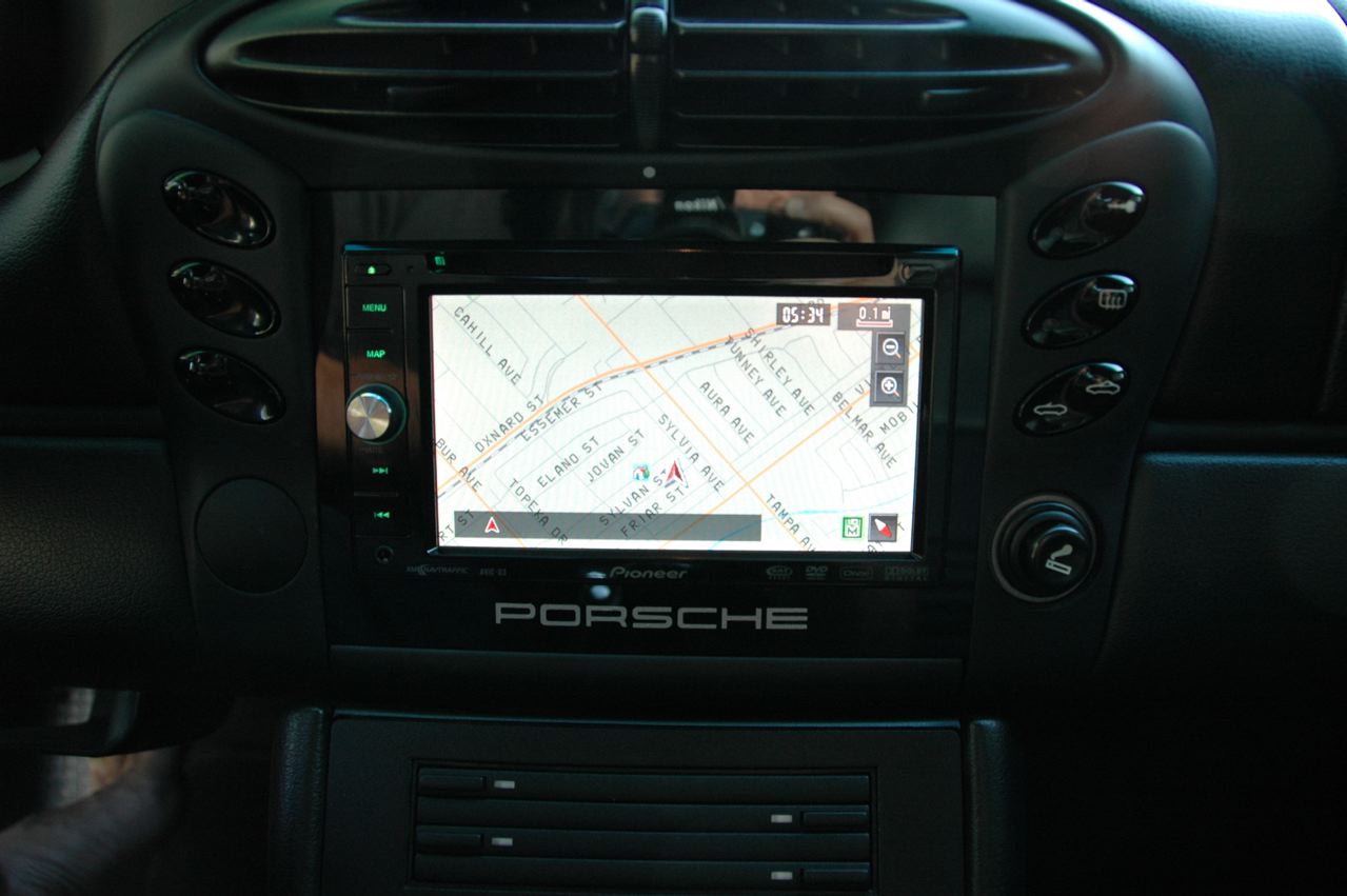

I bought a couple of these kits from these guys off ebays buy it now feature. My avic d3 came last night, so while watching tv i did the wire harness. Today when I had a chance with the sun getting ready to set, I pulled my 2001 boxster into the back yard opened up the old tool box and started following the DIY instructions. A little over an hour later I was putting the battery cable back on and starting up the car. It works great. Everything you get in the kit works perfectly and the fit is perfect. I have never attempted a radio install on anything before.
I would highly recommend this unit. I bought the cable for the ipod and put that in while I was installing everything. I found a refurb D3 unit on ebay for 487 a little over 500 shipped.

Hi There,
I recently purchased one of your kits for my 2000 996 CAB, just waiting for it to show up in my mailbox.
The only part I'm not sure of is how you put the climate control unit in the opening just below the AVIC, and above the empty cubby hole. I know you can buy a trim piece for the lower section. But I like you would prefer it where you placed the climate control unit.
Any help on this would be appreciated.
-Jay
Edited by Jayman996
Hi Jay,
I recently bought the same kit. In the directions they will explain how to use the existing trim kit to fit the opening your suggesting. I placed my AC in the bottom DIN and purchased that trim piece from Sunset Porsche for less than $10.00 including shipping.
Good Luck! Getting ready to complete my installation this coming week.
